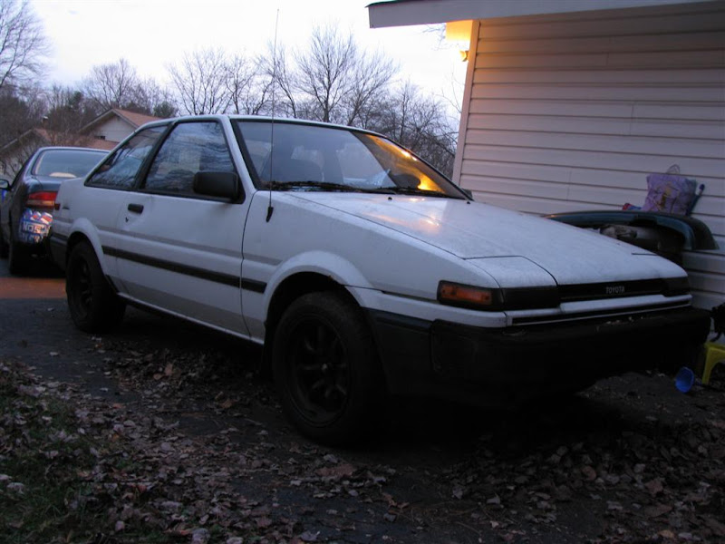

So, most people on here know that I have an AE86, and I've owned it for 7 years as of a week from now (March 22nd woo woo)... I have so many memories wrapped up in the car that it's hard to describe. To make a long story short, this project has been ignored for far too long, and I figured it's about time to at least get the car together again.
Just to recap my history with the car:
I started with
Then I tried:

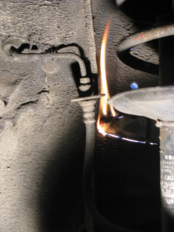

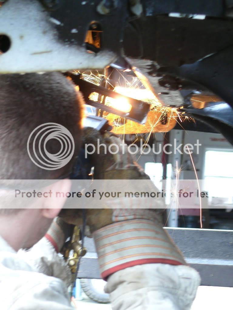

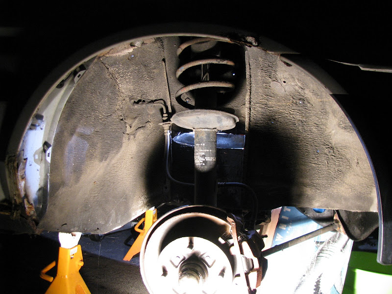

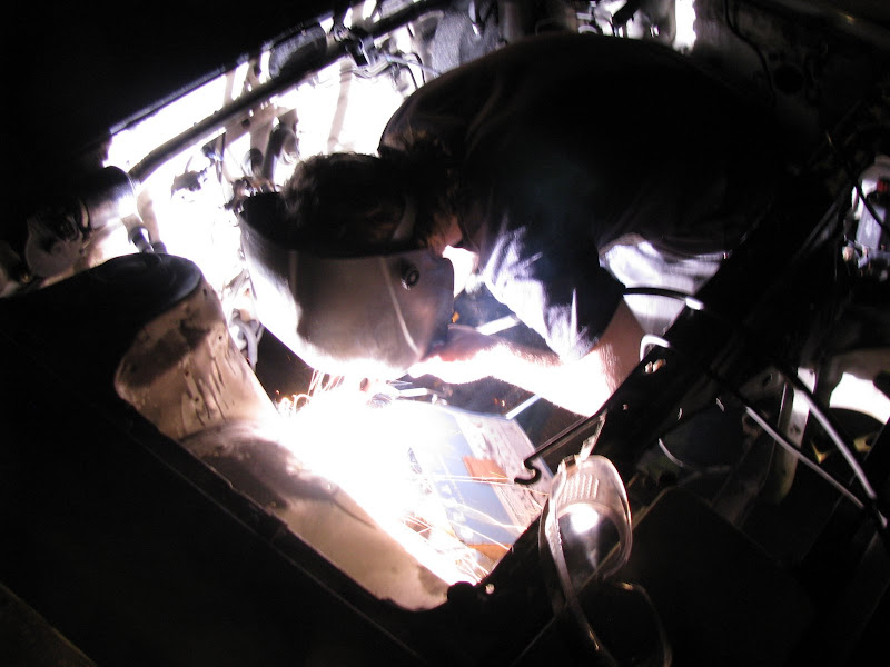

Spiros (garbageman4050 on the old board) welding in fresh metal in the engine bay, because I didn't trust my welding enough not to mess it up:

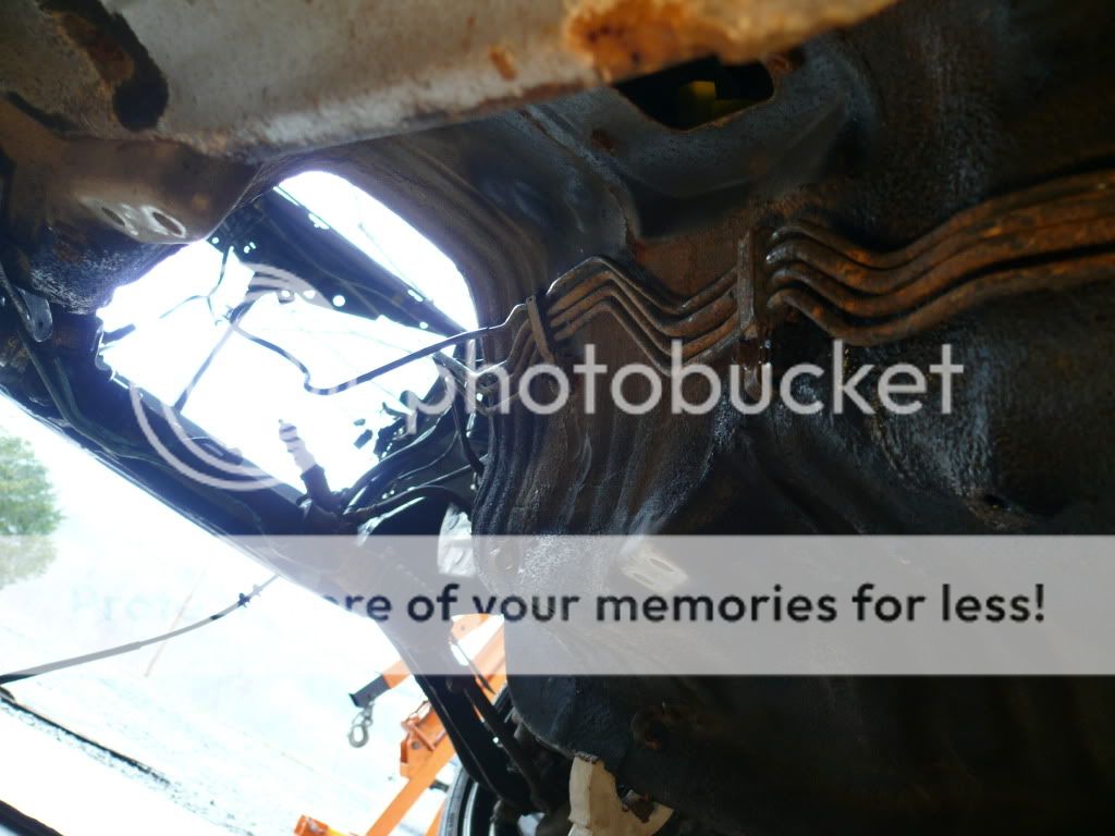

Burning Toyota undercoating smells like barbecue.
When I left the car alone in '09, it looked empty.

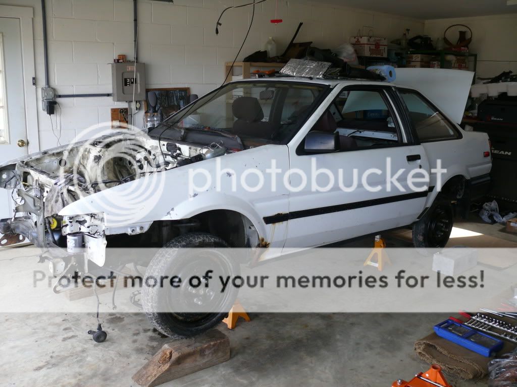

Let's fast forward to 2011.

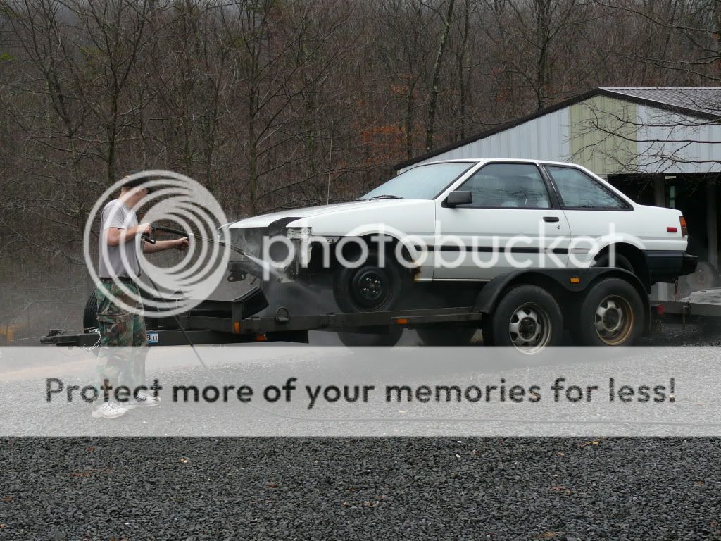

Swayton has once again graciously offered to help me get the car together by towing it down to his house and reassembling it there. Yoshi has once again assisted me by letting me borrow Hank & the trailer to move the car.
The patient, sitting on Yoshi's trailer:

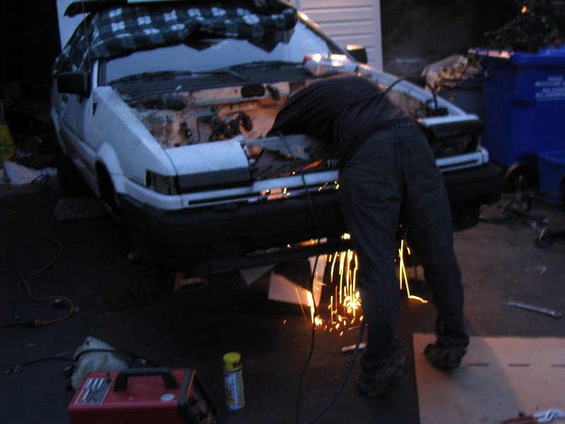

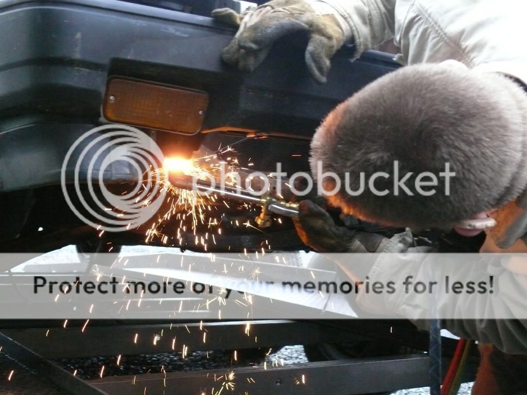

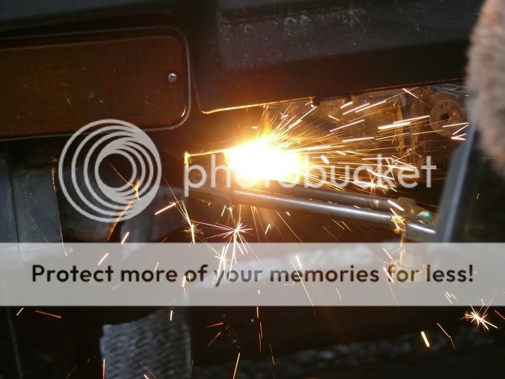

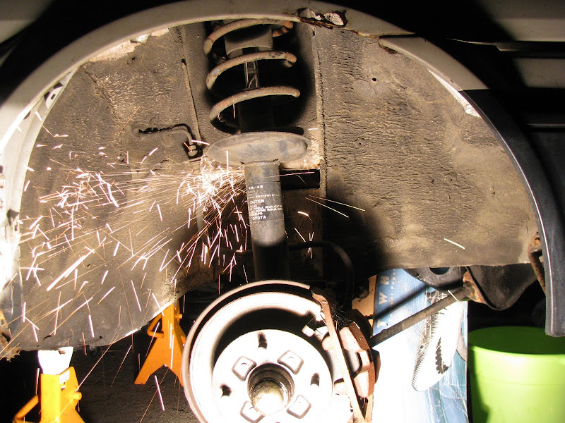

Swayton gets to work torching off the stuck front bumper support bolts after we tried removing them with no success.

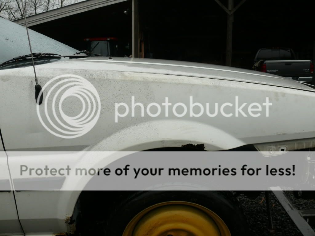

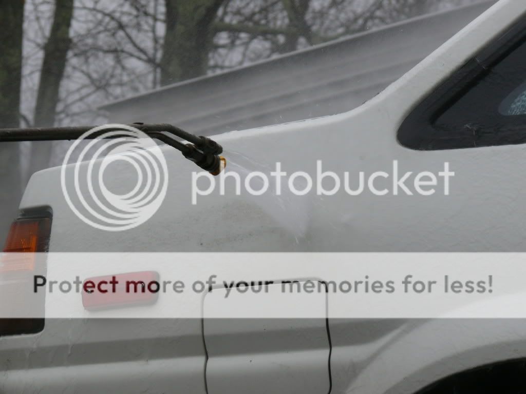

With the stuck bolts torched out, he wanted to pressure wash the car. I was worried about the integrity of the paint, but I realized at this point I'm going to need to repaint the chassis anyway.
So much dirt :/
Pressure washer in action; see the difference!

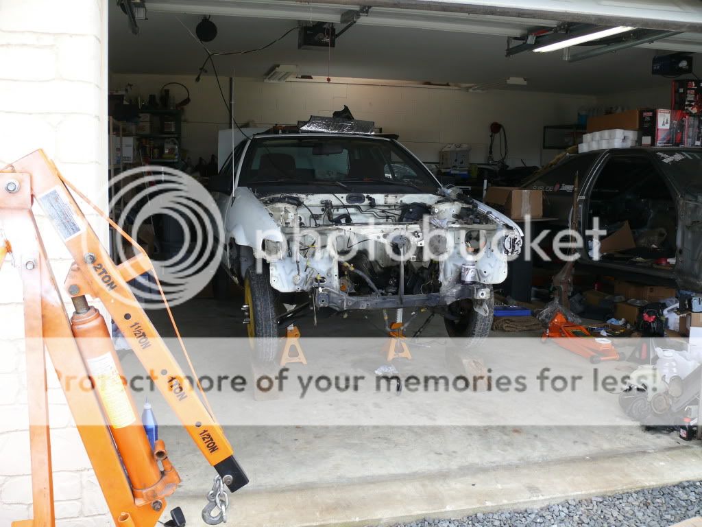

With the car cleaned up somewhat and the front bumper off for ease of access, we moved the car into his garage, as opposed to the shed due to the weather. Here are a couple of reference shots to show some of what we're swapping:

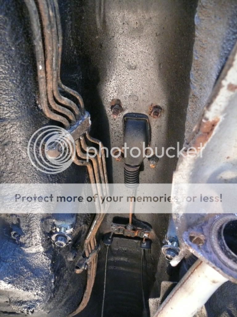

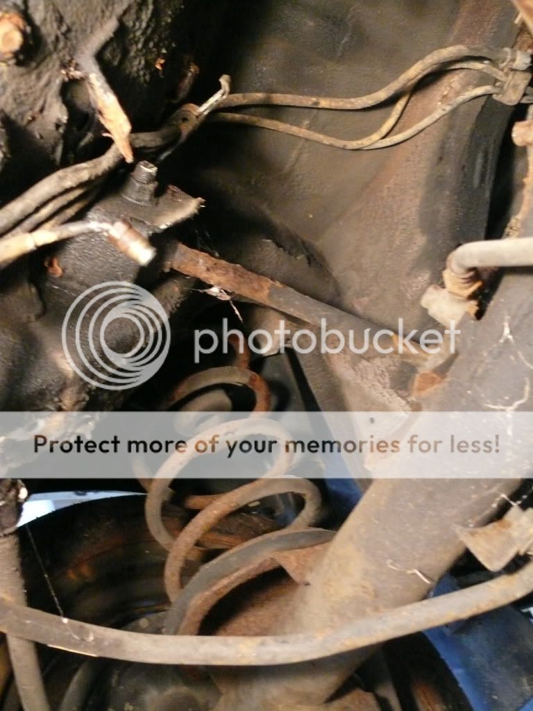

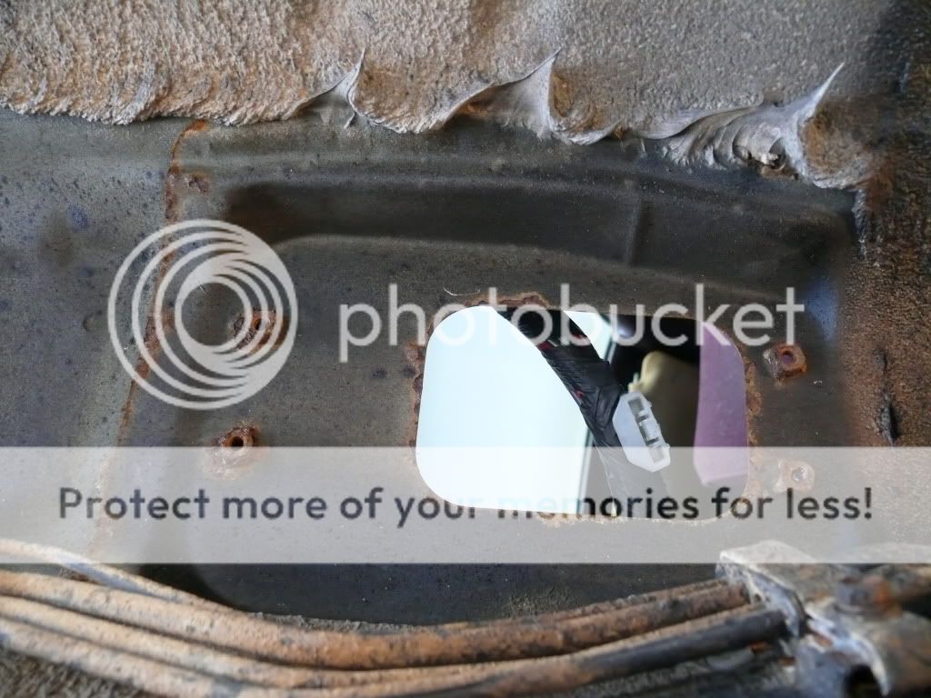

SR5 fuel and brake lines on the left, GT-S on the right. I apologize for the poor background choice, as the lack of contrast definitely makes the difference hard to see.

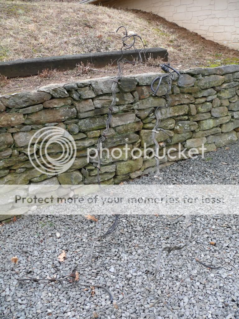

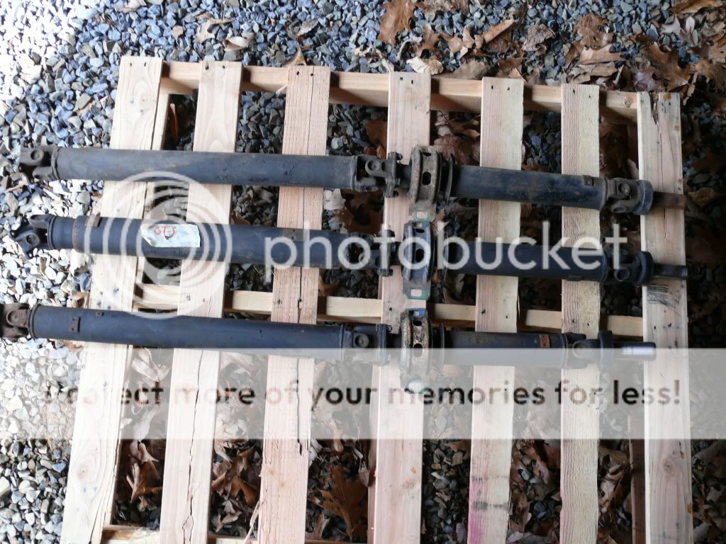

AE86 driveshafts, from the top:
SR5 manual
GT-S
SR5 automatic

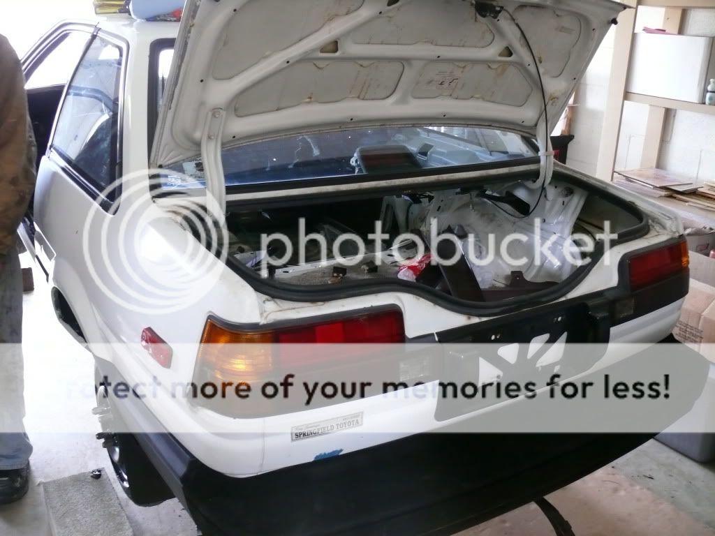

As the car sat at the end of the weekend in Swayton's garage:

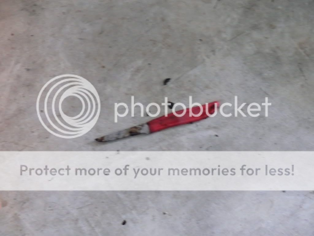

I was installing the GT-S wiring in the passenger side fender well when I found this knife, after it sliced up my right hand... I don't own any knives like this. Chalk it up as a (nasty) surprise from one of it's previous owners :(

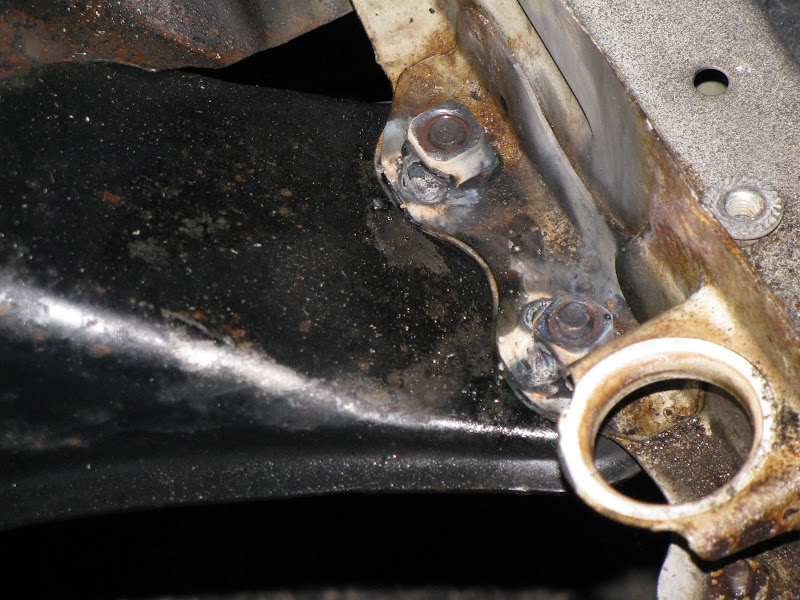

I have to cut the shifter hole open to fit the manual shifter's movement range, and ideally, cut off those nuts and reweld them so I can bolt on the inner shift boot for the manual shifter. Not looking forward to that.
Above pics are for future reference... Ideally, this car needs to get stripped down again whenever I have a place of my own so I can remove the rust and weld on reinforcement plates in some critical spots. Hopefully by the end of the next weekend I am down there, there will be a driveline installed. That brings you to the present day.
