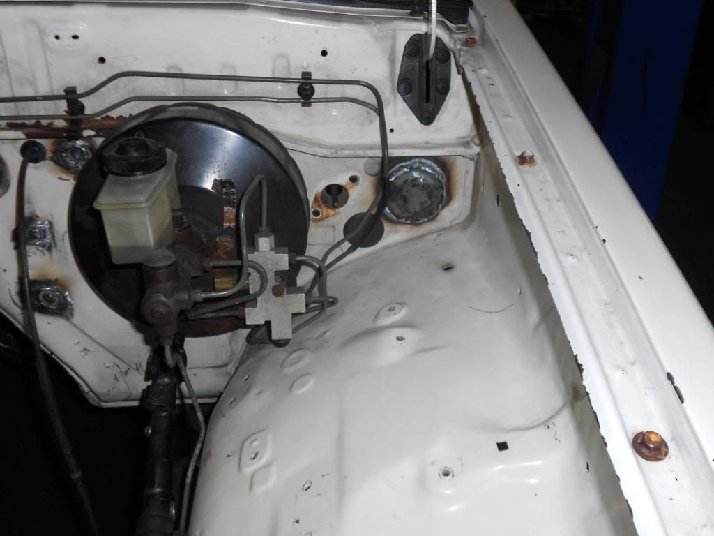

Whats up you guys my name is Gorka and I drift the Mazda pickup truck. At 100 drifters of December I blew my motor and was going to rebuild it but instead sold my turbo setup and got a 5.0 ho motor instead. I have been working on my truck like crazy this month and got alot done here's some pics of the progress

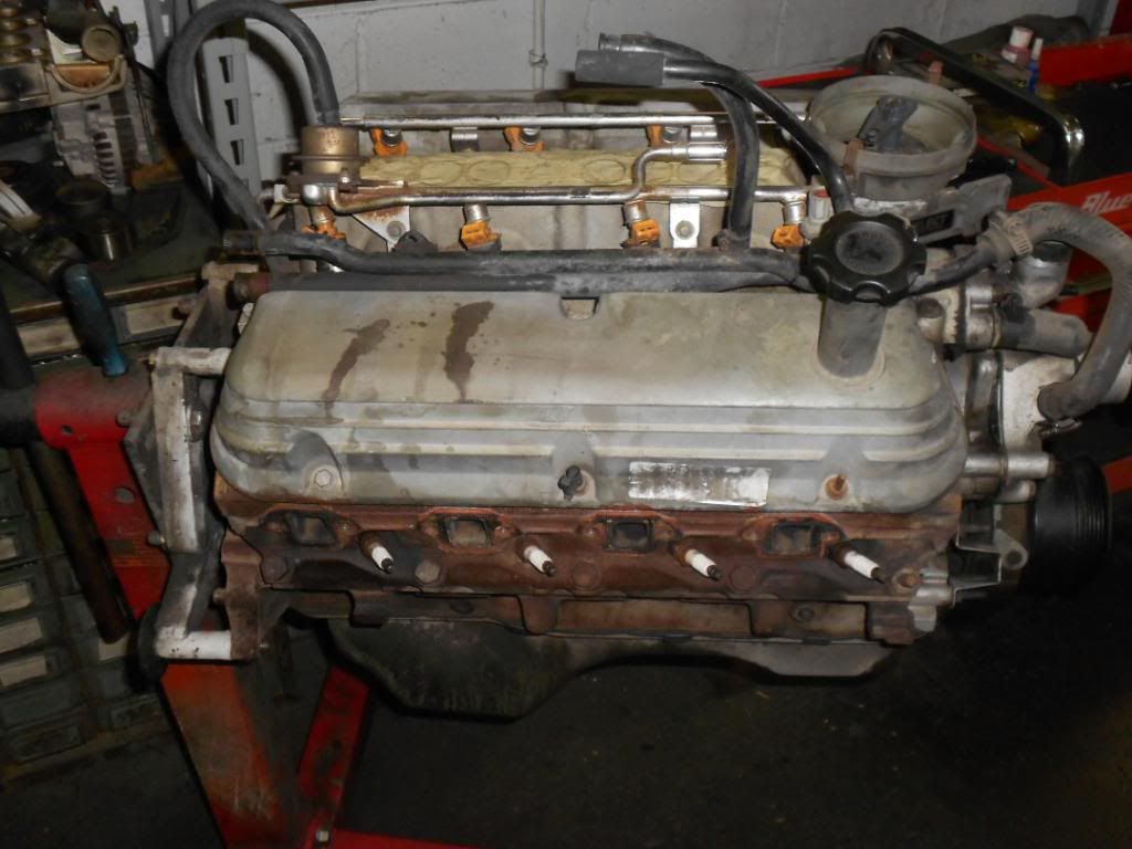

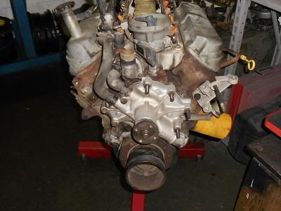

here the motor that i need to clean

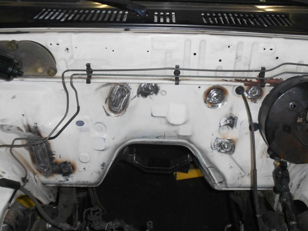

covered all the holes in the firewall

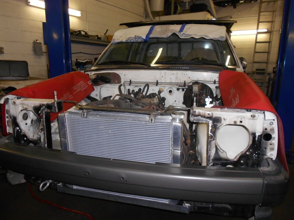

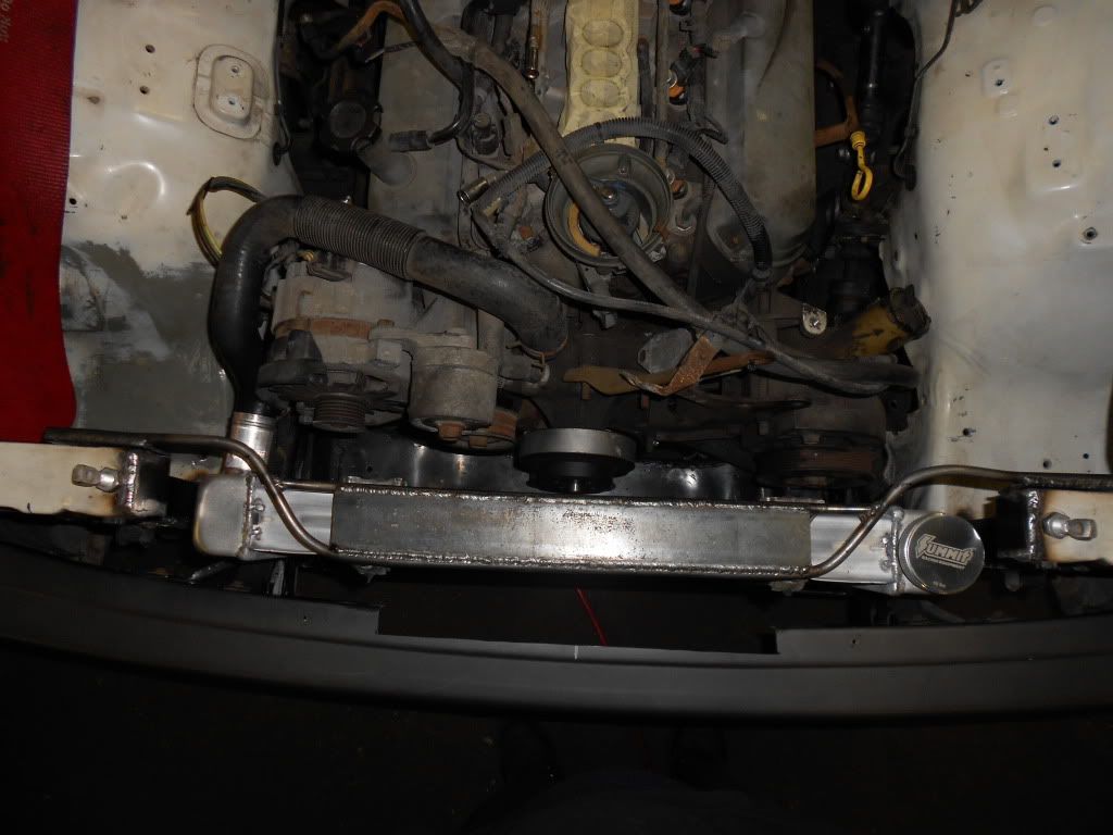

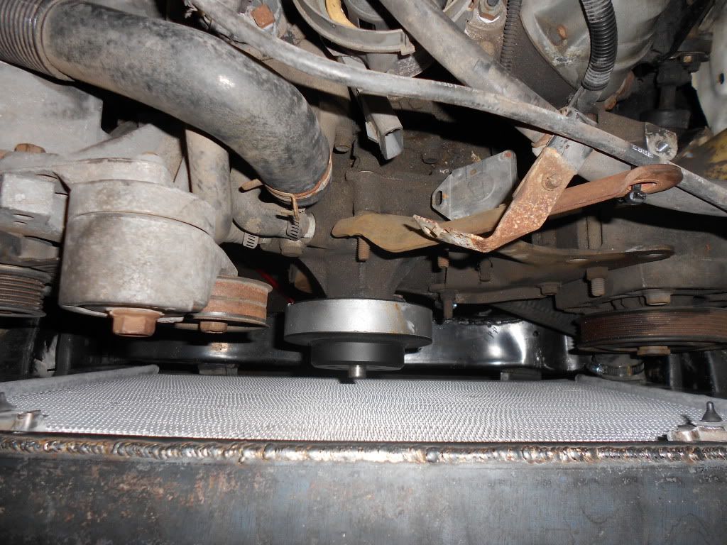

got the motor and trans in and stated mounting the Radiator

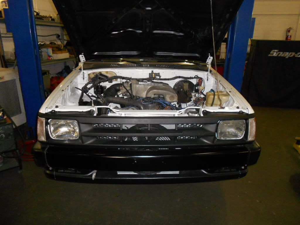

I got the engine bay cleaned and painted

made the core support detachable? how does it bolt back in?

there is two plate with welded nuts welded the back of the core support. I take 4 bolts out and it comes out. Here is the specs on my truck.

got some more work done. Took out the heater box,chassis harness and painted my dash black. I'm going to be making my own chassis harness.
I also got the motor back in the truck I will post up pics later

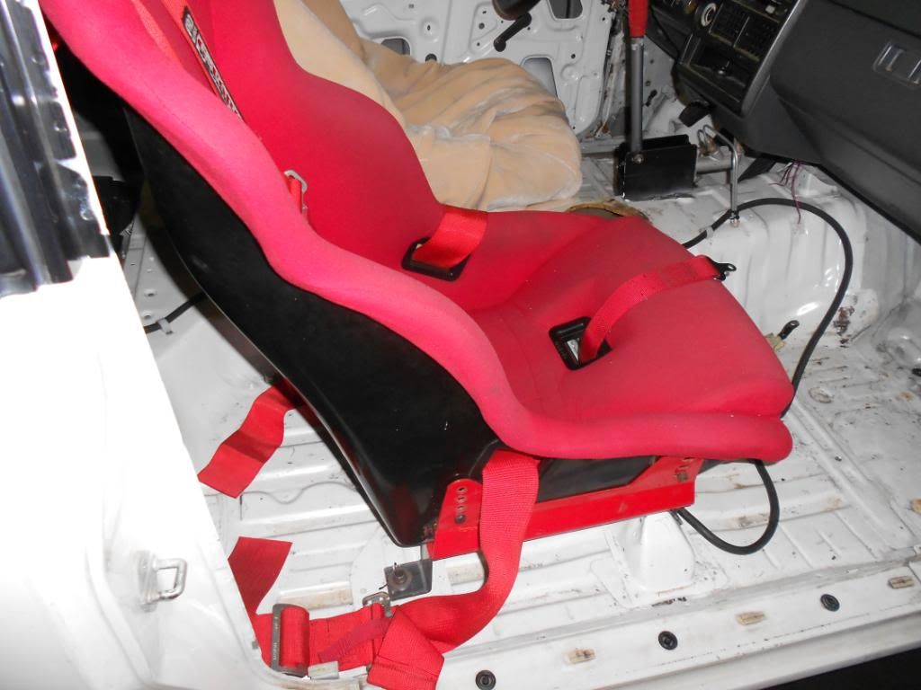

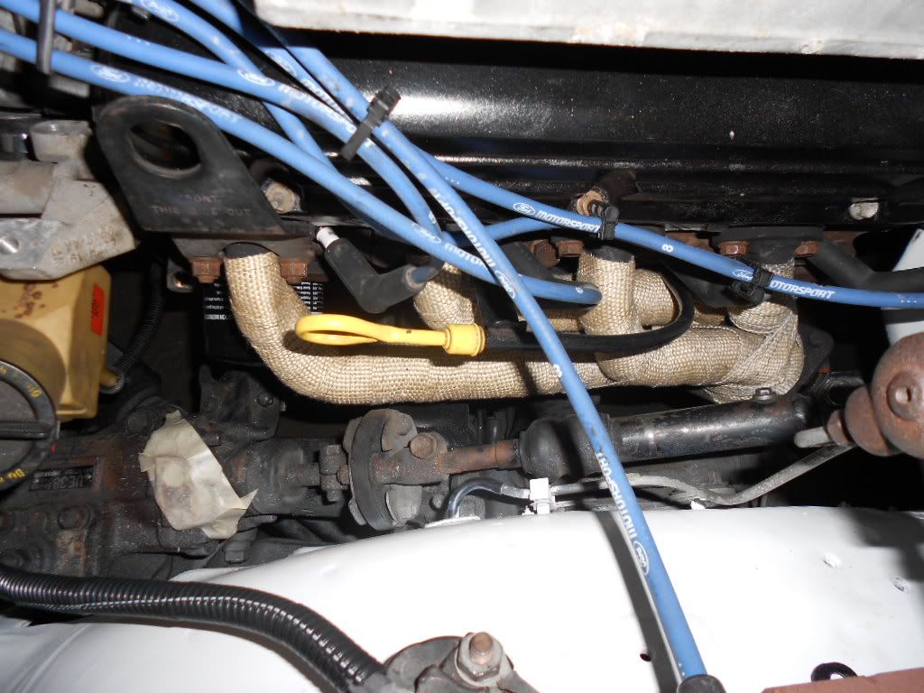

thank yoshi :D my motor is in. I also installed a sparco seat on the passenger side. need to start on the wiring not going to be fun!

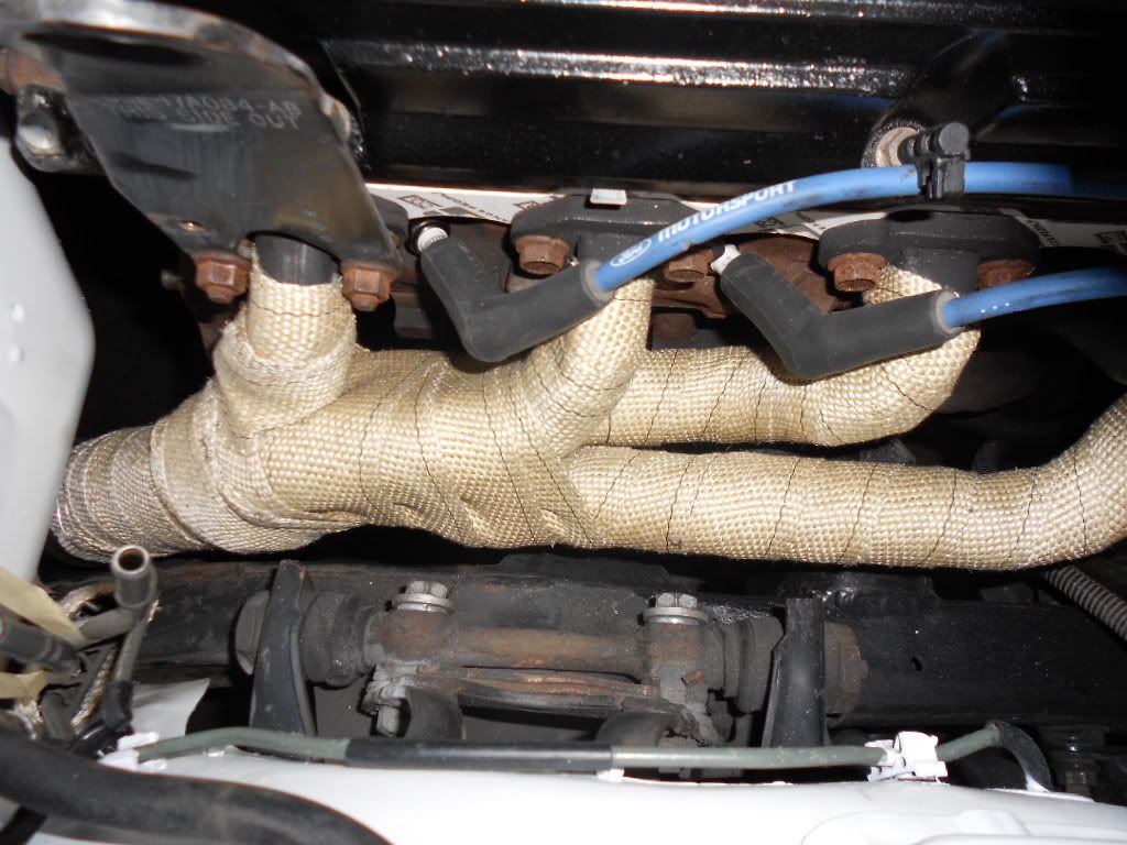

there isn't alot of room for my headers
